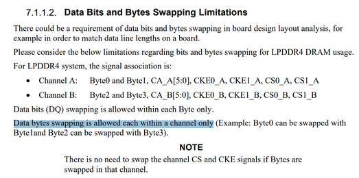

Hi I would like to doublecheck DDR4 pin swapping on S32G2
From S32G2HDG: S32G2 Hardware Design Guideline document,
I can see pin swapping allowed between Bytes if there are in the same channel.
But, it doesn't say other what channel the other bites are in
The channel is in this order? and for the other byte line there are also in numerical order?
