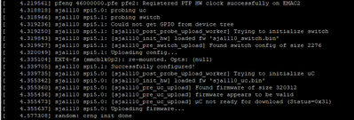

On which boot configuration do you have the SJA1110? This should be told by the J189, as shown under the RDB3 schematic:
The SJA1110 should be configured as "SDL Boot", since it will be booting from a serial interface (SPI). Once we configure the boot to be SDL, we have the following boot log:
Please, let us know.
