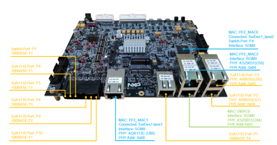

HI sir.
I am using the S32G-VNP-RDB3 board. I use the yocto bitbake the BSP42.0(fsl-image-auto).and boot up form SD card.
I want to use the 100BASE-T1 in the 100BASE-T1(MOLEX MINI 50 J53).
Could you help to tell me the next actions of how to enable 100BASE-T1 SJA1110 Port: P10(100BASE-T1)?
thank you.
Next is bootup logs.

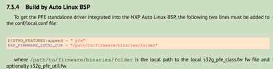

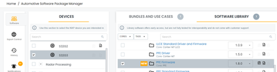

I suggest removing all your modifications to the conf/local.conf, then add the following two line only:(copy and paste them into your configuration file)
DISTRO_FEATURES:append = " pfe"
NXP_FIRMWARE_LOCAL_DIR = "/home/bin/fsl-auto-yocto-bsp/sources/meta-alb/meta-alb-bsp/recipes-kernel/pfe/pfe"
After it,  execute the following command to rebuild with the following command:
bitbake fsl-image-auto -c clean && bitbake fsl-image-auto
Chenyin

chenyin_h
Hello, @Wzlinux
I suggest removing the following two lines:
DISTRO_FEATURES:append = "pfe pfe-slave"
NXP_FIRMWARE_LOCAL_DIR = "/home/bin/fsl-auto-yocto-bsp/sources/meta-alb/meta-alb-bsp/recipes-kernel/pfe/pfe/"
Then rebuild the Yocto images to have a try
Chenyin

Hello, @Wzlinux
It is strange that there is no pfeng.ko under your directory, not sure if you set "pfe-slave " during the Yocto building, I had a test and the pfeng.ko could be found from my following directory:
/lib/modules/6.6.32-rt32-00903-g49d9f8bb25e0/kernel/drivers/net/ethernet/nxp/pfe/pfeng.ko
Would you please help to double check your Yocto building settings?
Besides, if you want to manually build the PFE Linux driver, then 1.7 version is required for BSP42, it could be built following the same way for building Linux modules.

this is my Yocto setting(conf/local.onf) contant:
MACHINE ??= 's32g399ardb3'
DISTRO ?= 'fsl-auto'
PACKAGE_CLASSES ?= "package_rpm"
EXTRA_IMAGE_FEATURES ?= "debug-tweaks"
USER_CLASSES ?= "buildstats"
PATCHRESOLVE = "noop"
BB_DISKMON_DIRS ??= "\
STOPTASKS,${TMPDIR},1G,100K \
STOPTASKS,${DL_DIR},1G,100K \
STOPTASKS,${SSTATE_DIR},1G,100K \
STOPTASKS,/tmp,100M,100K \
HALT,${TMPDIR},100M,1K \
HALT,${DL_DIR},100M,1K \
HALT,${SSTATE_DIR},100M,1K \
HALT,/tmp,10M,1K"
PACKAGECONFIG:append:pn-qemu-system-native = " sdl"
CONF_VERSION = "2"
# Parallelism Options
BB_NUMBER_THREADS = "32"
PARALLEL_MAKE = "-j 24"
DL_DIR = "/home/bin/fsl-auto-yocto-bsp/downloads"
SSTATE_DIR = "/home/bin/fsl-auto-yocto-bsp/sstate-cache"
ACCEPT_FSL_EULA = "1"
DISTRO_FEATURES:append = "pfe"
there are two s32g_pfe_class.fw s32g_pfe_util.fw files in "/home/bin/fsl-auto-yocto-bsp/sources/meta-alb/meta-alb-bsp/recipes-kernel/pfe/pfe/"

chenyin_h
Hi, @Wzlinux
Thanks for your reply.
From the log, the PFE FW seems integrated fine, but the PFE Linux driver is not seen initialized, I suggest checking it under your /lib/modules/, and try loading the PFE driver manually.
Chenyin

chenyin_h
Hello, @Wzlinux
From my opinion.
1. I suggest using the PFE1.8 FW as described in the BSP42.0 release notes.
2. In your conf/local.conf, seems you are using DISTRO_FEATURES_append += " pfe", instead, I suggest using DISTRO_FEATURES:append = " pfe".
Chenyin

chenyin_h
Hello, @Wzlinux
The PFE FW could be downloaded from the the following link:
https://www.nxp.com/app-autopackagemgr/automotive-software-package-manager:AUTO-SW-PACKAGE-MANAGER
Chenyin

chenyin_h
Hello, @Wzlinux
From the command you used to generate the image, it does not include the PFE support, I suggest reading the chapter 7.3.4 of BSP UM for details:
Also, thanks for @jiajun_cheng 's input
Chenyin

DISTRO_FEATURES_append += "pfe"
NXP_FIRMWARE_LOCAL_DIR = "/home/bin/fsl-auto-yocto-bsp/build_s32g399ardb3/PFE_Firmware_1_10_0/"

8,007 Views
Wzlinux
Hi @chenyin_h
Thank you.
Could you help to tell me how can i get the s32g_pfe_class.fw fw file and s32g_pfe_util.fw file?

chenyin_h
Hello, @Wzlinux
The 100baseT1 port is on the sja1110, which is connected to the PFE_MAC0 by default.
Firstly, you may add the PFE support to the image built(the pre-built images could include the PFE support by default), after entering the Linux shell, you may see the pfeX ports by ifconfig -a.
Then, you could try pinging PFE0 via 100base-T1 port.(assume that this port is directly connected to your testing devices like a host)
Chenyin

chenyin_h
Hello, @Wzlinux
Thanks for your post.
On RDB3, there are J53 Mini 50 connector and a harness cable for 100-Base-T1. you may connect the cable to your testing devices to test it.
If you do not have specific devices to connect to the cable, I suggest buying a RJ45-100BASET1 converter to have it tested.
Chenyin
