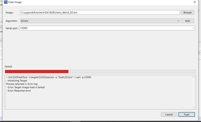

I have been facing some issues in the RGB led project of S32G-VNP-RDB2.
1. I have followed the same steps given in the software enablement guide but I'm not able to light up the RGB led.
Before i insert the SD card in the board and run the cat /proc/partitions command..i get the following partitions
Now after inserting the SD card also, i get the same number of partitions(is there a fault here).
Is the SD card not getting detected.
2. I tried using the flash tool but i keep getting this error. How to resolve this
sapna_12_2-1664429550402.pngsapna_12_2-1664429550402.pngsapna_12_4-1664429672572.pngsapna_12_4-1664429672572.png

Seems to be a problem with the SD card. When connecting the SD card, does it appears in the explorer? Has it been previously formatted?
As you told, if before connecting the SD and after connecting the SD does not change the partitions in the console, then it is not being detected by the system.
That could be the same problem for the S32 Flash Tool.
Let us know if this helps you or not.
