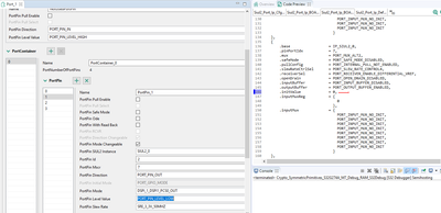

Regarding the Port configuration, there is a "PortPin Level Value" option, you should be able to set the initial value of the pin, which value are you defining?
If you would like for us to review any configuration, help us opening a ticket under the NXP online services, since it is not common for us to provide reviews under the community, we do apologize.
