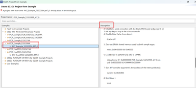

I would like to answer your second question first. From the picture, I see that the file named IPCF_M7_0_blob.bin that you put on the SD card. I want to know if this binary file is a blob image generated by you using the IVT tool? Or is it just named like this?
In fact, for the IPCF EXAMPLE, there is a detailed description here, and there are detailed steps as shown in the following figure. It should be noted that a blob image is not necessary. The directly compiled bin file can be used instead.
By using the prebuilt linux bsp40 image and following the steps above, I have no problems in operating.

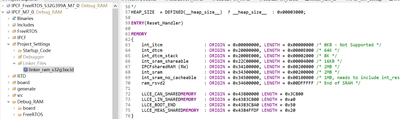

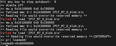

Two problems:
1.I can install ipc-shm-dev.ko but when I installed ipc-shm-sample.ko.The kernel resulted in panic.
2.I used the following command:"dcache off;mw.q 0x34000000 0x0 0x100000;fatload mmc 0:1 0x80000000 IPCF_FreeRTOS_S32G399A_M7_0_blob.bin;cp.q 0x80000000 0x34300000 0x60000;startm7 0x34500400;" And after I entered "boot", it occured kernel panic and could not continued. .

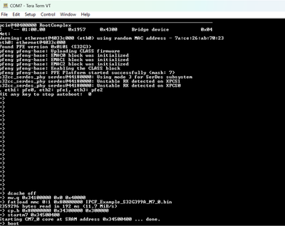

I have tried your suggestion.But the kernel loading can not continue.The log is as follows.Is there something else wrong?
Log:
U-Boot 2022.04-dirty (Sep 12 2024 - 14:17:18 +0800)
SoC: NXP S32G399A rev. 1.1
CPU: ARM Cortex-A53 r0p4 @ max 1300 MHz
Model: NXP S32G399A-RDB3
DRAM: 3.5 GiB
Core: 306 devices, 25 uclasses, devicetree: board
MMC: FSL_SDHC: 0
Loading Environment from MMC... OK
s32cc_serdes_phy serdes@44180000: Using mode 1 for SerDes subsystem
s32cc_serdes_phy serdes@44180000: XPCS0 is in reset
s32cc_serdes_phy serdes@44180000: XPCS init failed
pci_s32cc pcie@44100000: Failed to get PHY 'serdes_lane0'
In: serial@401c8000
Out: serial@401c8000
Err: serial@401c8000
Board revision: Revision Unknown: (0x717)
Net: eth0: ethernet@4033c000
Found PFE version 0x0101 (S32G3)
pfeng pfeng-base: Uploading CLASS firmware
pfeng pfeng-base: EMAC0 block was initialized
pfeng pfeng-base: EMAC1 block was initialized
pfeng pfeng-base: EMAC2 block was initialized
pfeng pfeng-base: Enabling the CLASS block
pfeng pfeng-base: PFE Platform started successfully (mask: 7)
pfeng_netif pfe0: Failed to get 'emac0_xpcs' PHY
, eth1: pfe0, eth2: pfe1, eth3: pfe2
Hit any key to stop autoboot: 0
=> dcache off;mw.q 0x34100000 0x0 0x40000;fatload mmc 0:1 0x80000000 IPCF_FreeRTOS_S32G399A_M7_0.bin;cp.b 0x800 00000 0x34300000 0x300000;startm7 0x34500400;
2359376 bytes read in 191 ms (11.8 MiB/s)
Starting CM7_0 core at SRAM address 0x34500400 ... done.
=> boot
switch to partitions #0, OK
mmc0 is current device
14555144 bytes read in 704 ms (19.7 MiB/s)
Booting from mmc ...
60860 bytes read in 94 ms (631.8 KiB/s)
## Error: "fdt_fixups" not defined
## Flattened Device Tree blob at 83000000
Booting using the fdt blob at 0x83000000
Using Device Tree in place at 0000000083000000, end 0000000083011dbb
Disabling XPCS0_0
Starting kernel ...
And it stopped here:

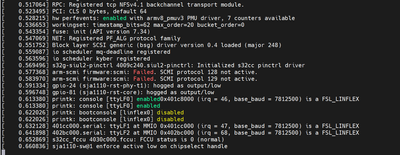

I used the rootfs and kernel source generated in the yocto.I built the image and dtb manually (fix phy config),but I did not changed the ipcf ko files generated in the rootfs.And when I installed the ko file .It still got panic..
root@s32g399ardb3:/lib/modules/5.15.145-rt73+g3a3fafb13baa+p1/extra# insmod ipc-shm-dev.ko
root@s32g399ardb3:/lib/modules/5.15.145-rt73+g3a3fafb13baa+p1/extra# insmod ipc-shm-sample.ko
[ 7.494024] pfeng 46000000.pfe: HIF2 started
[ 7.589045] pfeng 46000000.pfe pfe2: PHY [PFEng Ethernet MDIO.2:03] driver [mv88Q2112] (irq=POLL)
[ 7.589070] pfeng 46000000.pfe pfe2: configuring for phy/rgmii-id link mode
[ 7.591039] pfeng 46000000.pfe: HIF1 started
[ 7.691887] pfeng 46000000.pfe pfe1: PHY [PFEng Ethernet MDIO.1:03] driver [mv88Q2112] (irq=POLL)
[ 7.691913] pfeng 46000000.pfe pfe1: configuring for phy/rgmii-id link mode
[ 7.694032] pfeng 46000000.pfe: HIF0 started
[ 7.694050] pfeng 46000000.pfe pfe0: configuring for fixed/sgmii link mode
[ 7.694413] pfeng 46000000.pfe pfe0: Link is Up - 1Gbps/Full - flow control off
[ 7.694616] IPv6: ADDRCONF(NETDEV_CHANGE): pfe0: link becomes ready
[ 7.740501] pfeng 46000000.pfe pfe1: Set TX clock to 125000000Hz
[ 7.740539] pfeng 46000000.pfe pfe1: Link is Up - 1Gbps/Full - flow control off
[ 7.740564] IPv6: ADDRCONF(NETDEV_CHANGE): pfe1: link becomes ready
[ 41.180243] SError Interrupt on CPU1, code 0x00000000bf000002 -- SError
[ 41.180262] CPU: 1 PID: 381 Comm: insmod Tainted: G O 5.15.145-rt73+g3a3fafb13baa+p1 #1
[ 41.180270] Hardware name: NXP S32G399A-RDB3 (DT)
[ 41.180275] pstate: 60000005 (nZCv daif -PAN -UAO -TCO -DIT -SSBS BTYPE=--)
[ 41.180281] pc : ipc_shm_init+0x424/0x8b0 [ipc_shm_dev]
[ 41.180300] lr : ipc_shm_init+0x11c/0x8b0 [ipc_shm_dev]
[ 41.180310] sp : ffffffc0096eb9d0
[ 41.180313] x29: ffffffc0096eba60 x28: ffffffc000990078 x27: 0000000000000000
[ 41.180326] x26: 0000000000000000 x25: ffffffc000988340 x24: ffffffc00b100008
[ 41.180334] x23: ffffffc000988348 x22: 0000000000000000 x21: ffffffc00b100008
[ 41.180343] x20: ffffffc0009900b8 x19: 00000000000008d0 x18: ffffffffffffffff
[ 41.180352] x17: 0000000000000000 x16: 0000000000000000 x15: ffffffc0896eb85d
[ 41.180360] x14: 0000000000000001 x13: 007473696c5f7974 x12: 696e696666615f65
[ 41.180368] x11: 0000000000000040 x10: ffffffc008d91290 x9 : 0000000000000000
[ 41.180377] x8 : ffffff88011f9900 x7 : 0000000000000009 x6 : 000000000000024e
[ 41.180386] x5 : 0000000000000008 x4 : ffffff880123f5c8 x3 : 0000000000000000
[ 41.180395] x2 : 0000000000000003 x1 : 0000000000000001 x0 : ffffffc000988340
[ 41.180406] Kernel panic - not syncing:
[ 41.180408] Asynchronous SError Interrupt
[ 42.180556] SMP: stopping secondary CPUs
[ 42.388550] Kernel Offset: disabled
[ 42.392015] CPU features: 0x8,00002001,20000842
[ 42.396530] Memory Limit: none
[ 42.399572] ---[ end Kernel panic - not syncing: Asynchronous SError Interrupt ]---
6,154件の閲覧回数
