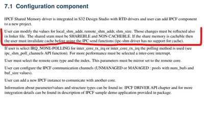

On the M7 side of things, I can see in the function ipc_shm_unmanaged_tx() the following:
	/* flush and invalidate dcache */
	ipc_hw_flush_cache_local(instance);
	ipc_hw_flush_cache_remote(instance);
D_CACHE_ENABLE is defined at compile time
So I believe the cache is being invalidated before tx, at least on the M7 side of things.
Actually testing with dcache on added after the M7 application has started seems to work ok and performance is significantly better, we're just concerned that we've missed something that could come back to bite us at a later date!

carlos_o
Hi @Lee_Mitchell,
The user manual of the IPCF 4.6.0 says the following:
[page 36, IPCF Shared Memory Driver User Manual, Version 1.17, 05/2022]
Could you help me answering the next questions?
1. Are you using S32G-VNP-RDB2 or a custom board?
2. Which version of IPCF are you using?
3. Which version of BSP are you using?
4. Are you using this same version for U-Boot and ATF? (In the case you are doing the compilation manually)
Regards.
