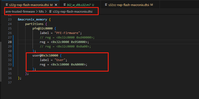

Dear engineers:
I am using the S32G274A RDB2 development board. In the ATF dtb, I adjusted the flash partitions. I plan to add a new user partition.
When I added this user partition configuration, the Uboot startup would fail. As shown in the picture.
When I disabled the user partition configuration, Uboot could start normally.
The partitioning is done in 64K byte alignment.
Are there any other points that need attention? We are very much looking forward to your responses.

This issue has been resolved. After modifying the dtb flash partition, both bl2_w_dtb.s32 and fip.bin need to be updated, not just bl2_w_dtb.s32.

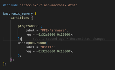

Joey_z
hi,liuchi
Thank you for your question.
I think you should pay more attention to the setting of the address. You can refer to the picture setting to add partition.
Hope it can help you.

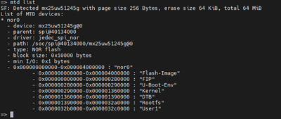

756件の閲覧回数
RandyKrakora
Assume you booting from QSPI?
Do you have your entire QSPI memory layout we could see? It seems somehow bl31 is in a place unknown to the atf.
-Randy

&qspi {
macronix_memory: mx25uw51245g@0 {
compatible = "jedec,spi-nor";
spi-max-frequency = <200000000>;
spi-tx-bus-width = <8>;
spi-rx-bus-width = <8>;
reg = <0>;
partitions {
compatible = "fixed-partitions";
address-cells = <1>;
size-cells = <1>;
flashimage@0 {
label = "Flash-Image";
reg = <0x0 0x4000000>;
boot@0 {
label = "BL2";
reg = <0x0 0xd0000>;
fip@d0000 {
label = "FIP";
reg = <0xd0000 0x1d0000>;
boot-env@2a0000 {
label = "U-Boot-Env";
reg = <0x2a0000 0x10000>;
kernel@2b0000 {
label = "Kernel";
reg = <0x2b0000 0x10d0000>;
dtb@1380000 {
label = "DTB";
reg = <0x1380000 0x30000>;
rootfs@13b0000 {
label = "Rootfs";
reg = <0x13b0000 0x1f10000>;
&macronix_memory {
partitions {
pfe@32c0000 {
label = "PFE-Firmware";
reg = <0x32c0000 0x950000>;
user@0x3c10000 {
label = "User";
reg = <0x3c10000 0xA0000>;
This is QSPI memory layout, the user partitions is the new partition
691件の閲覧回数
RandyKrakora
I reproduced the issue here, talking to our linux team to determine the cause and fix.
