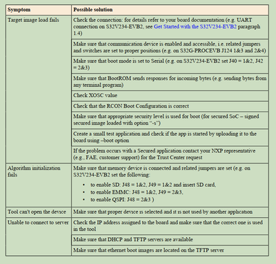

We built a few customized S32G3 boards. On two of these boards, when I tried to flash eMMC, I saw that the algorithm was loaded, but at the end, I got an 'Algorithm initialization is failed' error. A screenshot is attached. This eMMC failure occurred on both boards.
I also tried flashing QSPI. One board had the same algorithm initialization failure as eMMC, while the other successfully loaded the algorithm. However, I couldn't retrieve the flash ID or upload a file to the device afterward due to a communication timeout.
The S32G3 chips on these boards should be fine—I was able to use the S32 probe to load an ELF file into memory and run the routine. The rest of the boards have no issues. We checked the hardware and found no visible damage. We also used a Dediprog to program a known working QSPI image onto these two boards, but there was no console output.
Could you please advise what might be causing this issue?

For the possible reasons of the issues shown from your test, there are some useful information from the "troubleshooting chapter" of S32 flash tool user guide, as attached:

Hi @chenyin_h ,
Thank you for the information. It’s very helpful, and I appreciate your support.

I am not able to say that it is impossible for the issue you mentioned, but it is with low possibility that 2 of 7 silicon are damaged from our experience.
Flash tool is not a debugger, would you mind trying flashing the images with Lauterbach?
Not sure if the UART1 is available on your custom board, if yes, I also suggest building the UART RTD examples with UART1, and then load it to the SRAM via debugger to check if there are any prints or signals from the tx pin.

Likely hardware issue, may I know what is the percentage of devices with issues? since other boards with same design works fine with the flash tools.
Not sure if the two boards could boot from other methods like SD, if yes, may I know if the two boards could be operated correctly with UART, eMMC and QSPI via BSP or RTD?

Two out of seven boards have this issue.
We tried several approaches:
  1. Using the S32 Flash Tool to flash eMMC and QSPI failed because the tool reported an initialization failure.
  2. Flashing a working image to QSPI using Dediprog and booting from there, but unfortunately, there was no UART output. We measured the TX signal on the S32G UART and found no activity from the chip. Additionally, the power supply current was lower than on working boards, suggesting that the chip might be stuck. However, we could see an echo when typing in Minicom.
  3. Loading an ELF file into memory using the S32 probe appeared to work fine—we were able to run example code.
I believe the UART (connector and cable) on the board is functioning correctly. Could this issue be caused by damage to the chip, such as ESD or a soldering defect?

Since the issue existed on your custom board, may I know if the eMMC/QSPI models are different from the ones that on RDB3? which version flash tools used?

The eMMC and QSPI are exactly the same as on the RDB3, and the flash tool version is 2.1.7. Only these two boards have the issue—all other boards are working fine.
