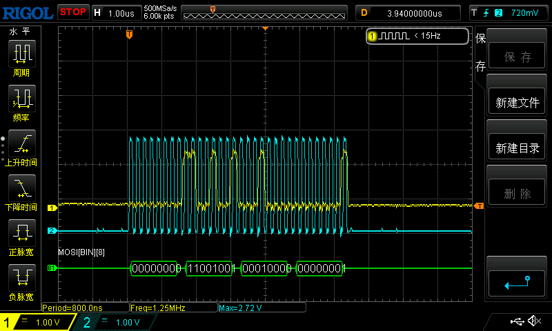

I am trying get data from SPI slave with SPI5
1、Slave device is PCS21125
2、CS is high active,Set PCSIS Bit0 to 1)
I want to know is anything speical need to when PCSIS Bit is set to 1。 thanks。。。。
1,046 Views
Bio_TICFSL
Hello zhaopingyang,
Is the QSPI connected, then its problem of PCS2115, because it is running ok.
