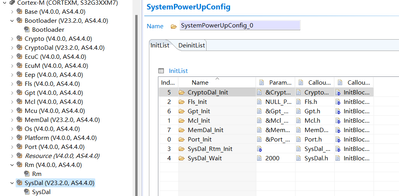

1) When config BootLoader in EB, I let the Rm enabled, because if I disable it compilation will failed due to errors; while AN13750 says it should be disabled. I configure the BootLoader as below:

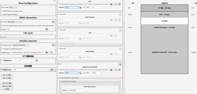

2)  When config IVT, I unchecked the HSE, while AN13750 says it should be configured. My IVT config is:

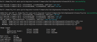

3) The uncertainty is, S32G3 LinuxBSP 35.0 UM document says the <plat> parameter must be replaced with s32g3xxaevb for s32g399ardb3 board. I am not sure is it correct or mistyped. My ATF build result is shown below, FYI
A1 >> Rm module should be disabled, as per AN13750. The compilation errors could be related to not deleting the output folder prior to generating the code, since the project maintains previous configuration. We can recommend the following community thread which talks about this situation:
A2 >> If you did not select the "Secure Boot" option, this is OK. If you have this option checked, then you will have problems where the Bootloader is waiting for the HSE Subsystem response.
A3 >> We seem to see what you are saying. The plat should be "s32g399ardb3" for RDB3 platform. This can be seen under the following path:
"arm-trusted-firmware\plat\nxp\s32\s32g\s32g3"
Where there is a folder for each platform variant under S32G3.

I checked my u-boot and ATF source and find that I got the latest(38.0) version. So I checked out the 35.0 version and built them again, and after I burn the newly generate fip.s32 to SD card, the board can bootup from SD card now.
But the board still cannot boot from nor flash after the newly generate fip.bin was burned to the flash, no information is printed via serial port.
The building result of ATF shows:

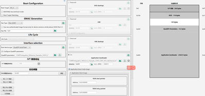

The boot source config is as below:
And the IVT config is as below:

Seeing the addresses set under the Bootloader, we understand that they are close to each other, and that could cause the images being rewritten incorrectly. Which IPCF examples are you using?
Seeing the default linker file provided under the IPCF examples we are not seeing the addresses you are using. We created a simple example and result in the following addresses being used:
We are able to boot both cores no problem from our side.
To verify the fip.bin file, you could also create an IVT/blob image where the AppBl is the fip.bin file, load the DCD and QSPI parameters and select the A53_0 as the boot core. If the fip.bin is correct, you should be able to boot from the QSPI interface and see the linux terminal being boot up. This if you want to confirm that the fip.bin is working.
