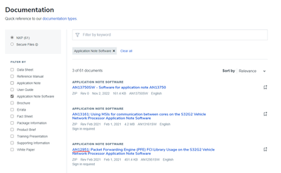

Yes, we have gone through the document AN12951, but where we can get the source code and binary file (BSP30.0) for "pfe_rte".

This is provided on the AN12951SW available under the same section that AN12951 is available. You can filter it by "Application Note Software".
