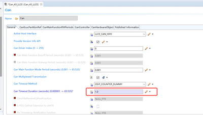

In the EB configuration, the default timeout value for LLCE is set to 1 second. We intend to reduce it (e.g., to 10ms) to avoid prolonged blocking in abnormal conditions, which may impact business responsiveness.

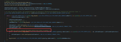

However, upon reviewing the LLCE driver code, we noticed this parameter is used in multiple places, some involving interactions with the S32G's LLCE core. Thus, we are uncertain about the minimum safe threshold to avoid potential errors.

Hi,chenyin_h
I understand what you mean, but in scenarios like the one below, I don't see how it relates to the customer's application requirements.

zyz
I understand this parameter should be configured per user requirements, but we can only evaluate it based on our specific needs. Since multiple driver interactions with the LLCE core depend on this parameter, we cannot assess the appropriateness of the timeout values for these scenarios. We're concerned that setting it too small may cause frequent LLCE response timeouts.
