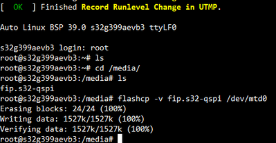

Recently, I tested qspi boot on EVB Gen3 board with SDK BSP39 and HSE v0.2.22 firmware.
But when I try to write fip.s32 image into qspi flash, the following error shows:
  root@s32g399aevb3:~# flashcp fip.s32-qspi /dev/mtd0
  While erasing blocks from 0x00000000-0x00180000 on /dev/mtd0: Connection timed out
And the whole test log is attached.
Would you please help to check the issue and give the reason?

The root cause of this issue is bad hardware connection of the EVB board. I checked the configuration of EVB and RDB. They are the same. and I can successfully flash image to QSPI by flashcp command. So please check the connection between S32G and EVB board.

This issue not happens with BSP38 image, and just comes out after updated to BSP39 image.
And also there is no this issue on RDB3 board, so I think the issue should be caused due to the BSP39 update, especially in u-boot update.
Zhantao
