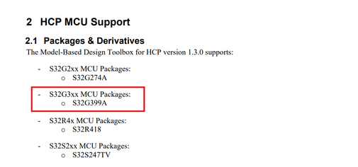

In general you can check the compatibility of any NXP software package in its respective release notes [page 2, Model-Based Design Toolbox for HCP, Release Notes, Version 1.3.0]:

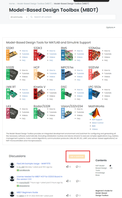

About posting in the MBDT community, please follow this link, and scroll down until you see the "Ask a question" button, then you can follow the same steps you followed to post in this community.:

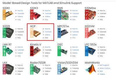

Model-Based-Design-Toolbox Main page, for S32G chips support check HCP:
Where you can find the following:

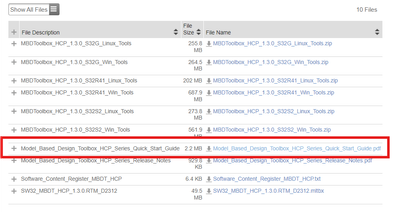

NXP Model-Based Design Tools/HCP How to: in here  you can see that the version you downloaded is in fact correct, and in the same page from which you downloaded the zip file you can find the documentation I mentioned before:
In this guide you will see how to install the MATLAB package and you will also see an example on how to debug a PIL target in section 2.3 A “Hello World” Example, page 26.
