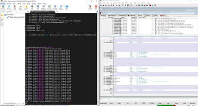

Hello ,
We are using BSPS 43 on Acore and autosar on Mcore
Acore is using pfe0,pfe1 and pfe2 and Mcore is using gmac
When the A-core is booted alone, PFE0 is able to successfully ping external IPs (e.g., 8.8.8.8). However, during a multicore boot (A-core + M-core), the ping fails.
To investigate this, we placed a breakpoint at the Mcu_InitClock() function in the M-core. Interestingly, when the execution is halted at this point, the A-core is able to ping successfully.
I have attached the screenshot below

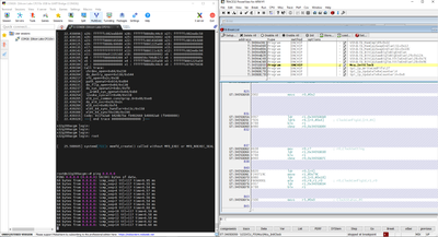

However, once the M-core is allowed to proceed beyond this breakpoint, the A-core freezes. As shown in the screenshot below
We have also observed that if we introduce a delay of approximately 5 seconds at the beginning of the M-core execution, the A-core is again able to ping successfully.
This further suggests that the issue is likely related to a conflict in clock or peripheral initialization between the cores.
