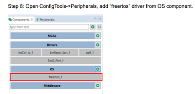

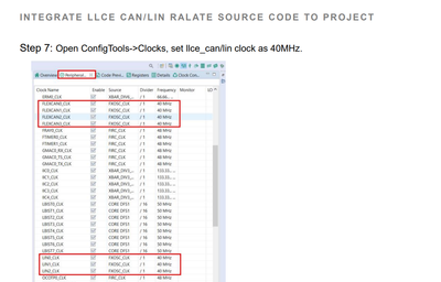

INTEGRATE LLCE_CAN/LIN(MCAL DRIVER) TO S32DS 3.4 [https://www.nxp.com/document/guide/getting-started-with-the-goldbox-for-vehicle-network-processing:G... I am referring this link to setup S32 Design Studio so that I can run the CAN examples given in the document. I had installed DS 3.4 and RTD, but unable to set the clock to 40 MHz and also the OS section is not coming up as shown in the screenshot
So, if exact detailed steps would be provided, it would be really helpful
