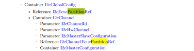

You can refer to the RTD_I2C_UM.pdf in the (SW32G_RTD_4.4_4.0.2/eclipse/plugins/I2c_TS_T40D11M40I2R0/doc/RTD_I2C_UM.pdf). The manual has the Reference I2cEcucPartitionRef and the Reference I2cChannelEcucPartitionRef to set the partitions.

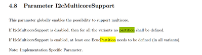

Yes,If I2cMulticoreSupport is disabled, then for all the variants no partition shall be defined.
If I2cMulticoreSupport is enabled, at least one EcucPartition needs to be defined (in all variants).

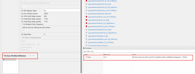

Arkadeep
Hi Joey,

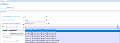

What if we tick multicore support and give ecuc reference of two partitions in same core ?
will it throw error ?

Refer to the RTD_I2C_UM.pdf, If I2cMulticoreSupport is disabled, then for all the variants no partition shall be defined. If I2cMulticoreSupport is enabled, at least one EcucPartition needs to be defined (in all variants).
The MulticoreSupport parameter is used to globally enables the possibility to support multicore. The I2cChannelEcucPartitionRef Maps one single I2C channel to zero or one ECUC partitions. And you also chose the EcucPartition and Coredefinition for OsApplication. The OsApplicationCoreRef is used to specify the core.
In other words, MulticoreSupport is for implement multicore partitions. If you want multiple partitions on the same core, although you can configure multiple partitions on the same core through OsApplicationCoreRef, but it does not have relevant documentation to describe this situation and cannot guarantee the corresponding effect.
