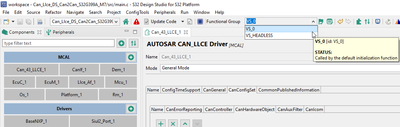

I am trying to run the demo provided in "LLCE Standard Driver and Firmware 1.0.7" using Design studio 3.5.
The demo is Can_Llce_DS_Can2Can_S32G399A_M7
1.After generating the code, while compiling I am getting "Llce_Headless.h:No such file or directory"
2.Why am i getting the error
"SDK PlatformSDK_S32XX_4_0_0_S32G399A_M7_0_4.0.0_PATH is not found in workspace"?
1,575 Views
Daniel-Aguirre
Are you looking to run the example under headless mode? Or not? Which Functional group have you selected under Config Tools? We select the following functional group:
And see no problems while compiling:
As for the following error:
It is related to a previous RTD installation. Can be dismissed.
Please, let us know.

1.I have now selected VS_0..... I think we will try the normal one without headless mode. And I am able to build it now....
