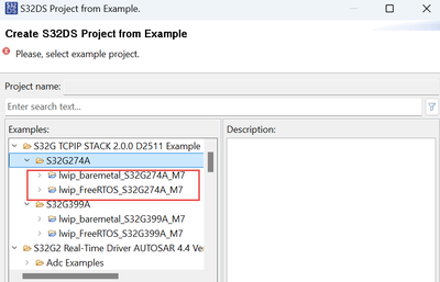

1. OK, I suggest using the lwIP demo based on GMAC, the PFE one is quite outdated, and the dependencies are not easy to find.

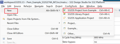

The lwIP demo(GMAC) for RDB2 could be found from the following page.
In order for obtaining it, you may need to install the S32G TCPIP stack and FreeRTOS packages provisioned by NXP from your NXP account to your S32DS, once installed, by pressing:
Then you may find the demo I mentioned.
2. By default, it is set with IPv4 address, current demo may not directly support IPv6. But I think IPv6 may be supported since it is only related with stack itself, you may need to enable it in lwIP and test if there are issues

Currently i am able to see the TCP/IP stack version which i am having is 1.4.0 the Image which you showed up is having the TCP/IP stack is having the version 2.0.0
Automotive Software Package Manager | NXP Semiconductors
i checked here where the S32G2 platform holds maximum of 1.4.0
For IPv6 it needs minimum of 2.0.0 or above. so where can i find the packages ?

1. Since it is not available from the software manager page, maybe it is not made public yet, I suggest firstly using the 1.0.4 version.
2. The 1.0.4 is the internal version for S32G TCP/IP stack, not the version of lwIP,  the lwIP used is 2.1.3, which could fulfill your requirements

Actually the Image which you attached TCP/IP stack is showing the 2.0.0 but currently i am using the 1.4.0  which is showing up like "S32G TCPIP STACK 1.0.4 D2310 Example projects".  so i guess i need to bring the TCP/IP stack 2.0.0
Can you please navigate where can i find the file that TCP/IP which you shared in snippet

You may check it in your NXP account, to see if it is available, if still not, maybe it is not made public to your NXP account yet.
As I mentioned, the 1.0.4/2.0.0 is the version number for "S32G TCPIP STACK", while this stack is basically based on lwIP2.1.3 or more recent version,  so that I think using the 1.0.4 version of "S32G TCPIP STACK" you mentioned is still correct for your requirement.
