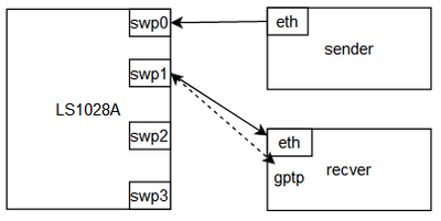

Hello
When I use LS1028 board to test QVB function,
The stream gate control did not take effect as expected.
I want to know why. Is there anything else that needs attention?
thank you
test steps:
1.set vlan
2.start gptp
3.tsntool > qbvset on swp1 with --basetime

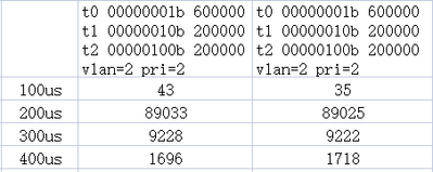

The sender sends 100000 records (priority 2)
test result:(100000 records)
