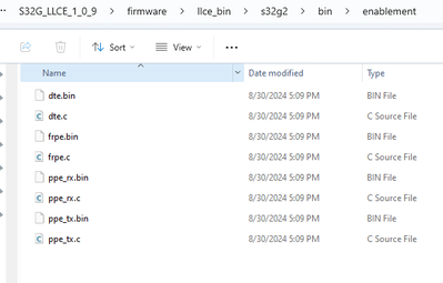

I am working on s32g274ardb2 board, i want to enable can i already modified device tree but i am unable to find these four binaries "dte.bin frpe.bin ppe_tx.bin ppe_rx.bin "  in my bsp38 can you please guide me where i get these four binaries.

You can find it as shown the following picture.
C:\nxp\S32G_LLCE_1_0_x\firmware\llce_bin\s32g2\bin\enablement
Hope it can help you.
