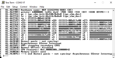

While trying to load IPCF sample in linux and when i entered this command,
insmod /lib/modules/`uname -r`/extra/ipc-shm-sample.ko
I received the following error
Please let me know how to proceed.

Can you let us know which BSP/RTD/IPCF versions are you working with? Also, are you working with an NXP reference board?
Please, let us know.

BSP 38.0, RTD 4.0.2 and IPCF 4.9.0
i am working with nxp s32g3 rdb3

Thanks for your feedback. Can you share the full boot log in which the commands of uboot are seen?
Also, did you build the BSP? Or are you working with the pre-built BSP provided by NXP (provided under a *.tgz file)?
