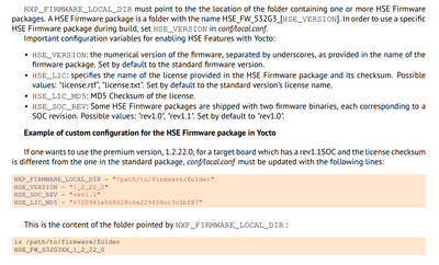

Hello @ashwini2024,
From the information of your Yocto configuration I assume you followed section 10.2 Building HSE Features with Yocto of the BSP40 user manual. Following the steps described in that section, at the end of it, there is an example of how to modify your configuration [page 77]:
Please let me know if adding these options changes the behavior.

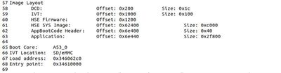

I am working on BSP 40 HSE version is HSE_VERSION="0_2_22_0" and enabling HSE features in the A-core and bootloader. I am using a multicore bootloader, but I am observing that the control does not transition to U-Boot from the bootloader, while the M-core AUTOSAR application is running in parallel. To debug the issue, I disabled the M-core, but the control still does not transition to U-Boot. This suggests an issue with the control flow reaching U-Boot.
The A-core log includes the following image layout:
Image Layout:
  • DCD: Offset: 0x200, Size: 0x1c
  • IVT: Offset: 0x1000, Size: 0x100
  • HSE Firmware: Offset: 0x1200
  • HSE SYS Image: Offset: 0x62400, Size: 0xc000
  • AppBootCode Header: Offset: 0x6e400, Size: 0x40
  • Application: Offset: 0x6e440, Size: 0x2f800
Boot Core: A53_0
IVT Location: SD/eMMC
Load Address: 0x346062c0
Entry Point: 0x34610000
I kept the load address as 0x346062c0 in the bootloader and set the QSPI flash address to 0x26e440 in the bootloader.

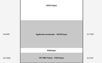

    The following is my blob :
The following shows the configurations on EB which suggests the source address in QSPI:
I suspect that the offset 0x1200 might be causing the issue and am considering the possibility of updating it on the A53 core.
Can you provide guidance on whether the offset 0x1200 could be causing this issue and if there are any additional steps or configurations I should verify to ensure a proper transition to U-Boot?

Hello @ashwini2024,
 The offset of 0x1200 should not be a problem, since it is the NXP implementation and cannot be changed. Can you help answering all questions I asked before? particularly these:

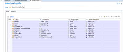

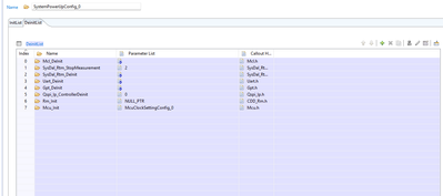

1) The initialised and deinitialised modules in the bootloader are as following :
2) Why does the A-core boot successfully in standalone mode using SD card boot, but fail to boot and get stuck when using serial boot mode? Here’s the error snippet:

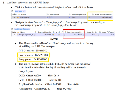

Have you being able to use this multicore bootloader in the past? before adding the HSE functionalities?
You mentioned that you are flashing the A-core image in address 0x200000 but I see in your screenshots that you are using a different source address0x26e440, if you check AN13750 in page 12 and 20, the load address and the address in which you flash the image have to match:
Also please note the match between the Load address (from the u-boot compilation log) and the load image at in Tresos, and the match between Entry point (from the u-boot compilation log) and the Reset handler address in Tresos:
Let me know if this changed the behavior in any way.
6,017 Views

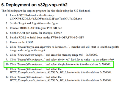

alejandro_e
Hello @ashwini2024,
I suggested to flash the qspi version because you are booting from qspi, performing some test I can see that using the fip.s32-sdcard results in the A53 cores not booting and using the fip.s32-qspi does boot the A53 cores. Can you help me with a test? can you boot only the fip.s32-qspi in address 0x00 of the qspi, then boot from qspi and let me know if you can see u-boot starting?
About the step by step guide, I was not able to find such document for the S32G3, however there is one for the S32G2, the AN13750 includes some steps related to the HSE. you can also check the Bootloader User Manual that comes with the Gold VIP package, which you can download from AUTO-SW-PACKAGE-MANAGER :
After installing the Gold VIP package you can find the user manual in the documentation folder.
Let me know if this information helped you.
