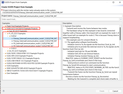

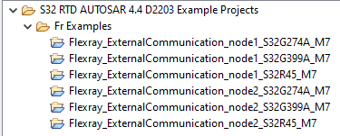

Miguel04
Hi @Wanyj
The examples provided under S32 Design Studio, are meant to be used as board to board, so you need to connect to board, each with one individual or unique node example. You can verify the examples by debugging them.
Best Regards, Miguel.

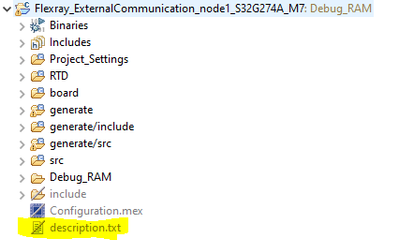

Miguel04
Hi @Wanyj
I'm happy to help you. You can verify the transmission by pausing the debug session and review the values of the RecieveArray or connect an oscilloscope to the pins to see the signal.
I also recommend you to look into the description.txt file on the example, here you will find a lot of details regarding the example, such as the supported hardware and the application software functionality.
Let me know if you have a question.

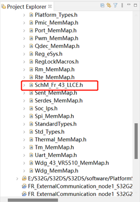

Wanyj
Hi,Miguel04
  •       I'm using the example from S32G LLCE 1_0_5,But now it fails to compile, it indicates that the SchM_Fr_43_LLCE.h file is missing, when I added this file, it also indicates that the definition of some functions is missing, I found that these functions are contained in SchM_Fr_43_LLCE.h.
  •     May I ask if the LLCE sample code is not available? Or there is something wrong with my method of use, and I have not found the exact operation steps on the official website. Please kindly answer it for me. Thank you for your help!
  •     As for your kindest regards,I hope you can answer my question

3,925 Views
Wanyj
Hi,Miguel04
    I am using the example shown below, however, it will have a compilation error, please take a look at the problem?
     These undefined functions exist in this.h file, and I added the dependency path myself, because at first it reported an error that the.h file could not be found.
     Hope to get your answer.Best Regards, Miguel.
