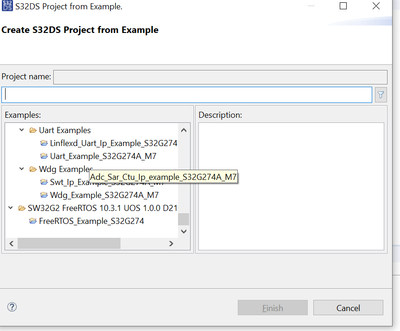

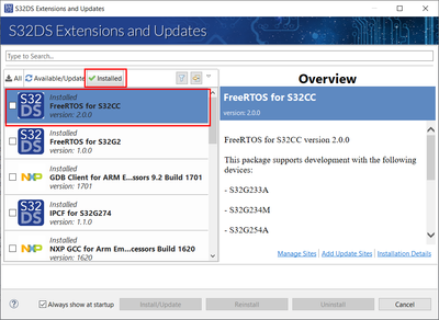

It is normal and as expected that S32G2 FreeRTOS extension plugin for S32DS does not display as an SDK, as long as you can see it in the Extensions and Plugins list:
You can start your FreeRTOS-based project by customizing the existing demo. The demo is available as a "Project from Example" template in S32DS:

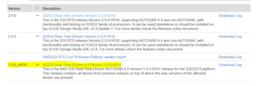

Note that FreeRTOS for S32G2 requires Relatime Drivers (RTD) package of 1_0_0 version:
If you have another RTD version installed, or don't have it installed it at all, the demo may fail at build time or may not display all components properly in the configuration tools. If that is the case, make sure you followed S32G2 FreeRTOS plugin Release Notes strictly: uninstall both FreeRTOS and the unmatching RTD, then install in that order: RTD 1_0_0, then FreeRTOS.

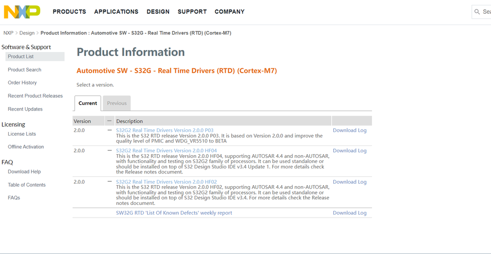

heshuwen
how can i download the SW32G_RTD_4.4_3.0.0_DS_updatesite_D2112.zip??
18,234 Views
JuWe
Hi Heshuwen,
I had the same problem, it's hard to find:
1) Go to your SW account 'SG32 Alpha Customer Enablement'.
2) You'll find 'Automotive SW- S32G Standard Software' there.
3) Go to Automotive SW - S32G - Real Time Drivers (RTD) (Cortex-M7)
4) Go to S32G Real Time Drivers 4.4 Version 3.0.0
5) Here you'll finally find SW32G_RTD_4.4_3.0.0_DS_updatesite_D2112
Juergen

heshuwen
Hi JuWe,
Thank you for your reply ,
I had go to Automotive SW - S32G - Real Time Drivers (RTD) (Cortex-M7),but can't find the S32G Real Time Drivers 4.4 Version 3.0.0
I only have the SW32G2_RTD_4.4_2.0.0_HF02_DS_updatesite_D2106.zip.
Or because of I'm not the SG32 Alpha Customer ?@bpe@markusregner
