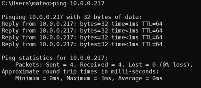

When enabling the GMAC RX interrupt, we checked the following box in the GMAC peripheral tool, as indicated by the integration manual.
We then set the interrupt for the GMAC RX in the interrupt controller and set the ISR handler as indicated by the integration manual.
After uploading the code and running it on the platform, we ran into the following issues as soon as a message was received by the GMAC. The code would get stuck here (file is NXP IP -> exceptions.c)
After doing some digging, we found the interrupt vector table under:
(Project_Settings/Startup_Code/Vector_Table.s)
The integration manual shows the NVIC Interrupt ID for the GMAC CH0 RX interrupt as following
But if we look under the vector table file, the interrupt for the GMAC RX interrupt was still set to undefined_handler:
The solution:
We wanted to confirm that this was indeed the issue, so we manually modified the vector table file, changing the undefined_handler to the correct ISR name:
After running the same code on the processor again, we successfully started receiving messages on the GMAC, just like we expected:
I hope this helps someone out there, and I hope this is helpful to the NXP team to help resolve this issue!
