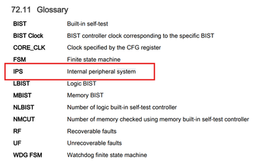

Hello team,
What is IPS bus used in S32G3 reference manual? At multiple instances 'IPS' abbreviation is used in multiple contexts. I am looking for its full form and specification. At one of the instance, I have noted it to referring as "Peripheral bus interface" as (IPS) which doesn't sound in accordance with the abbreviation. Is it (IPS) NXP proprietary? S32G2 S32G3 S32G-VNP-RDB3 S32G-VNP-RDB2

Hello  @kishanmishra ,
IPS stands for Internal peripheral system, you can find this definition in the S32G2 Reference manual section 72.11 Glossary [page 4063, S32G2 Reference Manual, Rev. 8, February 2024]:
I was not able to find this abbreviation expansion in the S32G3 reference manual, we apologize for the inconvenience.
Therefore the IPS bus is the bus used to communicate with the different peripherals.
Please note that IPS is different from IPs, the latter stands for the plural form of Intellectual property.
Let me know if this fully answers your questions.
