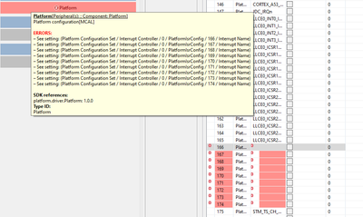

The 2nd problem is present in peripherals:
How I can to solve this problem?

The peripherals view is:
You can see that 9 lines (from 167 to 174) have no values.
The values on each line can be selected from drop-down menu, but I do not know what should be selected for each line

For the information you are providing, this behavior is expected by the NXP examples, since the requirement is to generate the code from Config Tools (which will add the required drivers). This is done by clicking the "Update Code" button. Once clicked and the code is generated, the errors should disappear. An example is shown below:

I tried other IPCF examples (IPCF_FreeRTOS_S32G274A_M7_0 and IPCF_Example_multi_instance_S32G274A_M7_0) and the same problem detected - all these have missed information about the same pins 166-174 that have not interrupt name.
