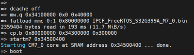

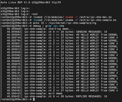

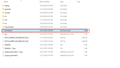

I used IPCF 4.9, BSP41 and IPCF_FreeRTOS_S32G399A_M7_0 demo for testing. No problems were found by referring to the description file. The operation method can be seen in the following figure. Please try to make sure that the M core and A core IPCF version is the same, about your BSP41 loading IPCF driver 4.10 problems, usually means that there is some kind of incompatibility between the module file and the kernel.

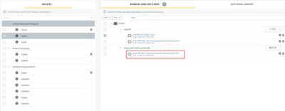

Access the Automotive Software Package Manager available under the Software section of the S32G product page (link:Automotive Software Package Manager | NXP Semiconductors )
Search for IPCF and download IPCF 4.9.0.
Your problem may be a version problem, I will further reproduce this problem, and help you solve this problem.
