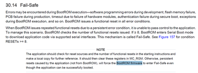

i have two questions about serial boot.
1.in chapter "30.3.1 Serial Boot mode", it mentioned "Serial Boot mode provides a mechanism to download executable recovery software to SRAM." do we have some demo/sample on this mechanism?
2.In chapter "30.14 Fail-Safe“(S32G2RM.pdf), is it possible to do "clear these registers in MC_RGM" by UART or by S32 Flash tool?

Take RDB2 as an example, you can change the settings of switches and enter serial boot mode.
Then you can refer to S32_Flash_Tool_User_Guide.pdf in S32DS.3.4\S32DS\tools\S32FlashTool\doc and burn the executed file into Flash/emmc/SD
