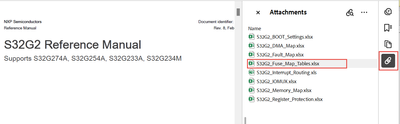

According to the S32G2RM.pdf and the Ocotp_Ip_WriteEFuse function, you can check ADDR_SYS and WRDATA_SYS register to know whether any data has been written to the specific eFuse address.

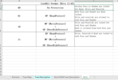

In addition , you can configure LockBit to use eFuse/shadow lock bit function by referring to S32G2_Fuse_Map_Tables.xlsx.

But crc error happens in case the data of specific eFuse address is updated and I cannot read the data of specific address,   LockBit is 0x00(Neither Fuse or Shadow are locked for Read, Write and Override)
