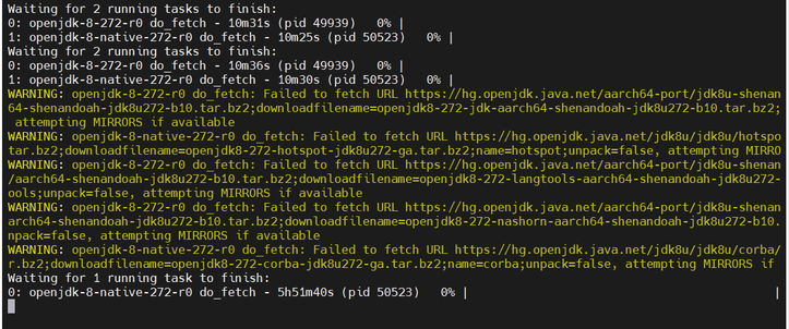

 Thanks for your reply! I was having trouble downloading openjdk-8 when using the "bitbake fsl-image-goldvip" command. Been waiting for openjdk-8 to download. Do you know why? Is it my own Internet reason? Thank you!

GuilhermeS32G
Hello @DRAVE ,
It is likely that your connectivity to the download mirrors is the problem. Although I did have problems downloading some files (namely xalan, avalon-framework-api, xml-commons-resolver), openjdk downloaded succesfully from my side.
It seems this problem with openjdk is not new:
https://community.nxp.com/t5/S32G/s32g2-goldvip-bitbake-failure-with-openjdk/m-p/1829915
In your case, you can stop this build by pressing Ctrl+C as it is clearly stuck.
When some files cannot be downloaded directly from Yocto, one option is to download them manually and placing them in your downloads folder. The next time you start the build, bitbake will detect these files and will not attempt to download them again.
You can try to download the missing files from this mirror:
https://mirrors.kernel.org/yocto-sources/openjdk-f89009ada191.tar.bz2
https://mirrors.kernel.org/yocto-sources/openjdk8-272-corba-aarch64-shenandoah-jdk8u272-b10.tar.bz2
https://mirrors.kernel.org/yocto-sources/openjdk8-272-corba-jdk8u272-ga.tar.bz2
https://mirrors.kernel.org/yocto-sources/openjdk8-272-hotspot-aarch64-shenandoah-jdk8u272-b10.tar.bz2
https://mirrors.kernel.org/yocto-sources/openjdk8-272-hotspot-jdk8u272-ga.tar.bz2
https://mirrors.kernel.org/yocto-sources/openjdk8-272-jaxp-aarch64-shenandoah-jdk8u272-b10.tar.bz2
https://mirrors.kernel.org/yocto-sources/openjdk8-272-jaxp-jdk8u272-ga.tar.bz2
https://mirrors.kernel.org/yocto-sources/openjdk8-272-jaxws-aarch64-shenandoah-jdk8u272-b10.tar.bz2
https://mirrors.kernel.org/yocto-sources/openjdk8-272-jaxws-jdk8u272-ga.tar.bz2
https://mirrors.kernel.org/yocto-sources/openjdk8-272-jdk-aarch64-shenandoah-jdk8u272-b10.tar.bz2
https://mirrors.kernel.org/yocto-sources/openjdk8-272-jdk-jdk8u272-ga.tar.bz2
https://mirrors.kernel.org/yocto-sources/openjdk8-272-jdk8u-aarch64-shenandoah-jdk8u272-b10.tar.bz2
https://mirrors.kernel.org/yocto-sources/openjdk8-272-jdk8u-jdk8u272-ga.tar.bz2
https://mirrors.kernel.org/yocto-sources/openjdk8-272-langtools-aarch64-shenandoah-jdk8u272-b10.tar.bz2
https://mirrors.kernel.org/yocto-sources/openjdk8-272-langtools-jdk8u272-ga.tar.bz2
https://mirrors.kernel.org/yocto-sources/openjdk8-272-nashorn-aarch64-shenandoah-jdk8u272-b10.tar.bz2
https://mirrors.kernel.org/yocto-sources/openjdk8-272-nashorn-jdk8u272-ga.tar.bz2
Something that you may try is to download all the required files before start building the image. To achieve this, you may use the command:
bitbake -k fsl-image-goldvip --runall=fetch
If there are errors downloading files, you may either retry or manually download them and place in the correct folder until no files are missing.

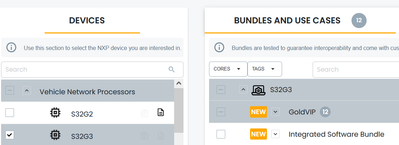

As described in the GoldVIP link:
https://www.nxp.com/design/design-center/software/automotive-software-and-tools/s32g-vehicle-integra...
It integrates NXP standard and reference software, along with open source and third-party software to provide an evaluation, development and rapid prototyping platform.
GoldVIP is not a Yocto project, there are A53 side code(BSP), M7 side code included, for using it, I suggest referencing the document included in the GoldVIP packages, especially the user manual.
By the way, you may get the GoldVIP from the following link:
https://www.nxp.com/app-autopackagemgr/automotive-software-package-manager:AUTO-SW-PACKAGE-MANAGER
I hope it will help.
By the way, we are doing a GoldVIP user survey(https://forms.office.com/e/9iwTrQCWi0), thanks for filling it out if you feel interested in the GoldVIP, any input from the customer would help us on improving the quality for GoldVIP.
