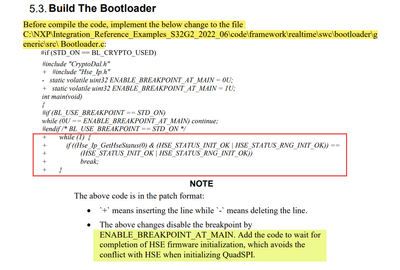

Are you using RDB2 or RDB3? It is suggested you can refer to AN13750 to check the configuration of bootloader and IVT images.
Joey
1,995件の閲覧回数
ddmiso
Dear Joey_
Also, I use BSP39.0 version. The content of AN13750 document is 2022 document. Is there anything to be careful about when using it in compatibility with BSP39.0?
1,976件の閲覧回数
Joey_z
hi,ddmiso
Thank you for contacting us.
Usually, The AN13750 supports the Multicore Application, It is the official document. you also can refer to the AN when you use the newer BSP39.0, but you should pay attention to the Software compatibility.
Regarding your question, you can try modifying the Bootloader.c to refer the AN as shown in the following picture.
In addition, you also can use the HSE 0.2.22, It is recommended for goldvip.
Hope it can help you.

Thanks for your reply. I was able to boot successfully.

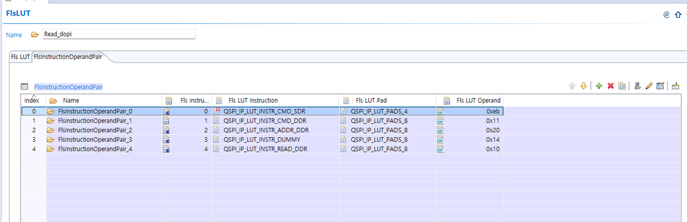

The NOR flash Memory of RDB2 board is MX25UW51245G. It booted normally with this flash, but my custom board uses MX25U6432F. This memory uses Quad SPI, so I think I need to change the Fls setting.
Can you guide me on how to set it up?
Changing memory size and device id.
There is an error in the part below Read_dopi.
