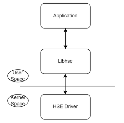

chenyin_h
Hello, @ashwini2024
Thanks for your reply.
I have roughly finished checking the HSE lib/driver in the BSP, currently, libhse could provide low level APIs of HSE for user application, The application could  initializes the HSE service descriptor and requests an HSE service via the LIBHSE, as following:
If your application could use this kind of APIs to communicate with HSE, then it is relatively easy for the application development.
For hash operation, you may reference the code pkcs-msg-digest.c from https://github.com/nxp-auto-linux/pkcs11-hse/blob/release/bsp42.0/examples/pkcs-msg-digest/pkcs-msg-....
I made a few modifications on this code and found that the results seems correct with the prints of openssl(done by CPU) from the same inputs, while the HSE is indeed called by the appllication
[ 3960.223129] hse-uio 40210000.mu0b: device hse-uio v2.1 open, instances: 1
[ 3960.237253] hse-uio 40210000.mu0b: device hse-uio v2.1 released, instances: 0
But if your application could not use such kind of APIs(for example, you have to use the openssl APIs), then other additional code development would be necessary.
Hope it will help.
Chenyin

chenyin_h
Hello, @ashwini2024
Thanks for the reply.
About your new question, from my experience, as I have listed before, two path that may fulfill your requirements:
1. If you are willing to develop kernel driver/kernel module, theoretically you may directly use the hash API of HSE driver for your own use, no document nor example code existed, you may have to learn the HSE kernel driver in details and develop your own kernel code to use the Hash APIs from the following:
https://github.com/nxp-auto-linux/linux/blob/release/bsp41.0-6.6.25-rt/drivers/crypto/hse/hse-ahash....
2. If you are willing to develop a Linux user space code, you may reference the pkcs11-hse project from the path I shared, combine the chapter 10 of BSP 41.0 UM, your own user application could directly use the common openssl API to finally access the HSE. The advantage of this way is that there are already BSP UM existed, you may learn it and use the openssl application to directly call the existing functions, for them to do the hash by the HSE, but you may have to reference the current openssl application to learn how to integrate it to your own user space application.
I hope the information above could help on your questions.
Chenyin
