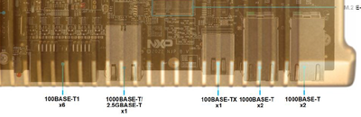

chenyin_h
Hello, @ankitv
You are welcome, we feel glad to hear that the issue is fixed
Regarding to the network interface:
  1. By default. the 100Base-TX directly connected to the SJA1110 switch, you may use it by typing ifconfig pfe0 x.x.x.x in Linux.
  2. 1x2500base-T is connected to SerDes1_lane1, by default, it is mapped to the  PFE_MAC1, as a result, you may use it by typing ifconfig pfe1 x.x.x.x.
Best Regards
Chenyin

ankitv
Hi @chenyin_h
Yes, it is working now. Thanks for sharing the information.
However, I found that only 4 ports of 1000Base-T x2 ports are working. How do I enable the 1000Base-T/2.5GBase-T x1 and 100Base-TX x1ports ? Thanks
-Ankit
