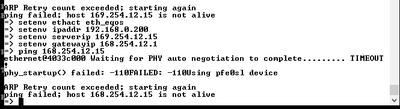

I would like to explore the feature of TFTP protocol for flashing binary
i have attached the snap below that i found while setting up the tftp environment
i was fallowing AN13727 for this features
Kindly let me know what exact procedure i need to follow for the over all setup
so i can just flash the binary using below cmd over tera term
"tftp $loadaddr  goldvip-gateway.bin "

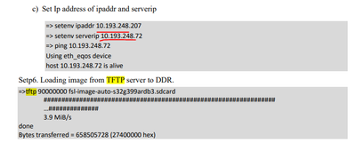

For the information that you have shared, we understand that the ipaddr being set is different than the serverip (at least the first 3 numbers). As seen under the example inside AN13727, these numbers should be matched:
Please, let us know.

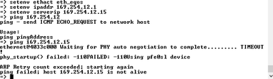

Karthik_7
Hey @Daniel-Aguirre ,
Thanks for the response,
I have done changes as per your suggestion but still the status is same .
Could you please let me know, over all procedure I need to check before going through these steps.

Thanks for your feedback. Can you confirm that the IP 169.254.12.15 is the IP from your computer?
In general, 169.254 is a private IP (Internet Protocol) address that the device automatically assigns itself when it can't get a valid IP from the router's DHCP (Dynamic Host Configuration Protocol) server. Essentially, getting any IP that begins with 169.254 tells you that something isn't working (Why Do I Have the 169.254 IP Address? - WhatIsMyIP.com®).
