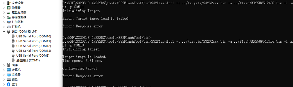

   We use flashtool , when downloading the program to norflsh through s32G2 serial port 0, the serial port chip has been chaged, but 3 of the 5 boards appear to obtain the chip ID or display The Resolution error #3 is displayed when the algorithm is loaded.
The dialing code has been set to the all off state. After downloading the program through the burner, observe that the uart0 print message and receive information are normal.
What does the error #3 stand for? Are there special restrictions on the hardware of UART0, thank you.

You could have a try using the FlashTool command to write the image into QFlash, please refer to S32_Flash_Tool_User_Guide.

     We have try use  the FlashTool command to write the image into QFlash the response error also happen at Win10 system ,but we find when we use linux flashtool at  VMware ubuntu16 it works well.
So it's may be something wrong with windows flahtool,What's the default uart BdRate,we can't fond place to set it,Also we use a new ft4232 usb2uart chip.We just want use it in windows computer,

But we still can't download image,The error ais like this picture.
 But we still can't download image,The error alwaya like this.ResponseError.

That error mean that the board is not responding, it is on; connected Could be many reason for that, but is not software issue.
