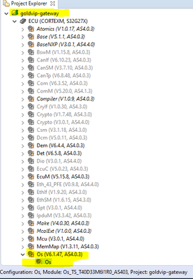

I am doing some configurations for OS and after doing the configuration  and while generating the configuration I am getting this error.
The error says " Mandatory parameters are not configured and please check if all the default validation rules are enabled".
So, below are my two queries:
1. What are the mandatory parameters required to configure in OS.xdm. And is there any documentation available for it(if yes, please provide me the link for it, it will be really helpful for me).
2. What are default validation rules?
Versions used:
EB Tresos : 28.2
Please let me know what are the correct versions to be used to configure this.

What version of GoldVIP are you using? What version of EB ACP do you have installed? Do you have the same issue with the default application?
Without too much information regarding the changes done over the default configuration, we can only suppose what would be the issue here. We couldn't notice there are a lot of modules disabled - there might be some dependencies or references from other modules (i.e., EcuC). Please check the "Problems View" tab to ensure there are no other issues that could stop you from generating the configuration.
The Os module included in this configuration is developed by Elektrobit. Please refer to the documentation found under the <EB_ACP_Install_path>/doc/ directory to find more info regarding this specific module.
