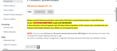

  1. You can download EB from the link I provided. We have provided a license for the EB , as shown in the following picture.
  2. Regarding S32G, we have provided the BSP for A53 and RTD for M7. You can use the BSP software package to bring up the S32G Cortex-A53.
