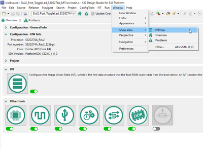

I've followed the SW-UG up to the section where i'm required to configure the IVT, but the images on the powerpoint and the available options on my S32 DS differ vastly ( See attached images ). This means i can't follow the guide correctly and so don't believe i should attempt to write to the SD card.

Regarding the IVT view issue you are seeing, it is related to (it seems) that the IVT view was closed prior to the project being loaded, hence you are not seeing the proper view. Below will be an image showing where to load the IVT view that the Software Enablement Guide is using.

Thank you for your reply, your fix for the missing IVT options was correct and i have now written to the SD card. Following the rest of the steps i can see the rgb LED turn on (if only very faintly).
