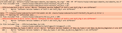

Hi All,
I'm facing an issue during the compilation for the SW version mismatch between RTD driver and configuration files.
Please help me if any of you have come across this issue.
Ravindra
1,891 Views
bpe
The screen capture you provided displays paths that do not belong to RTD.
If you are trying to use RTD with another NXP software package, refer to
that package documentation on the compatible versions of RTD. Usually, this
information can be found in the README file or in the Release Notes, depending
on the package.
