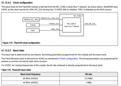

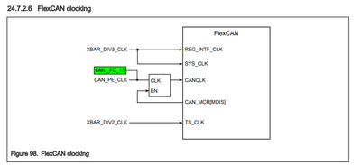

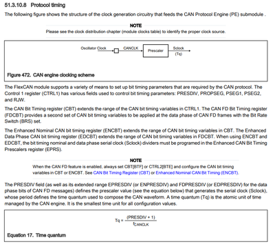

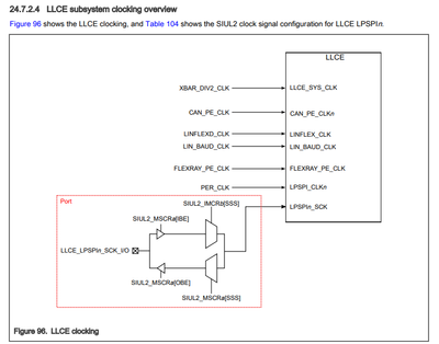

carlos_o

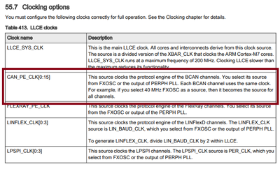

Hi @Abhiram_m_s,
You need to review your clocking configurations from the LLCE side at your M7 core.
[page 2768, S32G3 Reference Manual, Rev. 4, 02/2024]
For FlexCAN with the A53 Core review the following:
[page 2619, S32G3 Reference Manual, Rev. 4, 02/2024]
Reviewing the Clocking chapter of the RM.
[page 921, S32G3 Reference Manual, Rev. 4, 02/2024]
[page 918, S32G3 Reference Manual, Rev. 4, 02/2024]
As you can see LLCE and FlexCAN shares the Clock for transmit you need to review your configuration of each module to use the same prescaler to match the frequencies in both transmit options.
Some other important information to know here is where this clock is generated:
[page 1346, S32G3 Reference Manual, Rev. 4, 02/2024]

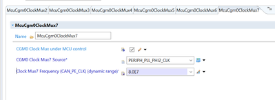

carlos_o
Hi @Abhiram_m_s,
The clocks can be modified at the ATF side, but for the problem you are presenting there can be a multiple reason of it.
The first is to verify which clock is selecting the CGM_MUX_7 when you start the M7 and if this is the same or change when you start the A53 Core.
Could you please share the configuration of the M7 side of the CAN_PE_CLK and the CGM_MUX_7? If CGM_MUX_7 is selecting the PLL_PH2 please share the values of it.
5,628件の閲覧回数

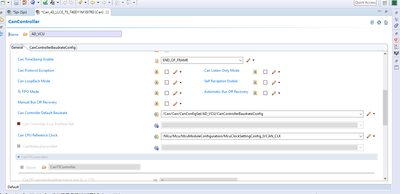

Abhiram_m_s
The m core configuration is here below
Please let us know how to go ahead. 

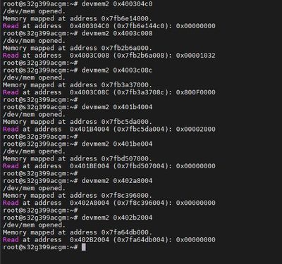

carlos_o
Hi @Abhiram_m_s,
Thanks for sharing your configuration of the CAN CLK in the M7 core.
Can you run the following commands in linux after boot?
devmem2 0x400304c0
devmem2 0x4003c008
devmem2 0x4003c08c
devmem2 0x401b4004
devmem2 0x401be004
devmem2 0x402a8004
devmem2 0x402b2004
This command is mapping registers to user space, I want to see how the kernel is configuring the FlexCAN registers and the PLL & CGM registers
5,485件の閲覧回数
Abhiram_m_s
Hello Carlos
I ran the commands given by you and the output is as follows
5,281件の閲覧回数
carlos_o
Hi @Abhiram_m_s
Thanks for sharing the output of the registers.
It seems that the clock that LLCE and FlexCAN use is not being modified by the kernel configuration.
Did you run these commands right next to power up the A53 core? if yes, can you run it again after configuring the CAN transmit in the A53?
Also, can you share how are you configuring the A53 to use FlexCAN?

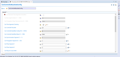

I am attaching my Mcore side can configurations
Baud rate configurations are attached below :

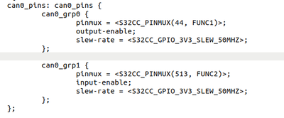

ans : All clock configurations is handled in Bootloader, there is no clock configuration in Acore.
I will attach the screenshot of the Devicetree below
Abhiram_m_s_5-1742991546397.pngAbhiram_m_s_5-1742991546397.pngAbhiram_m_s_6-1742991554875.pngAbhiram_m_s_6-1742991554875.png
