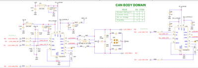

When I checked the circuit diagram of the S32G-VNP-RDB3 board, 3.3V was supplied to TXD, EN, and STB for the BCAN0 transceiver.
In BCAN1, 3.3V was not supplied to TXD, EN, and STB for the transceiver.
Therefore, we assume that routing is not possible in combination with BCAN where 3.3V is not supplied.

For the following part of the schematic of RDB3 (which you previously said you are using), we see the following:
Where BCAN_0 and BCAN_1 share the control signals (EN and STB), for which if BCAN_0 is being enabled, BCAN_1 is also enabled. Are you using an NXP reference board? Or is this a custom board?
As for the available BCAN's, all BCAN's are being supplied with the necessary voltages, as seen under the RDB3 schematic, unless it was modified or it is a custom board.

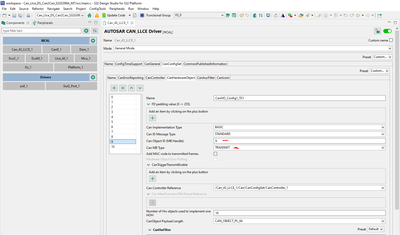

The changes made to the basic sample are as follows.
New addition to CanHadWareObject in Can_43_LLCE module,
Additional content
Name CanHardwareObject_11
CanHandleType BASIC
CanIdType STANDARD
CanObjectId 9
CanObjectType RECEIVE
CanTxAddFrameMac false
CanHardwareObjectUsesPolling false
CanControllerRef /Can_43_LLCE_1/Can/CanConfigSet/CanController_1
CanHwObjectCount 20
CanObjectPayloadLength CAN_OBJECT_PL_64
Name CanHwFilter
CanHwFilterCode 273
CanHwFilterMask 2047
CanAdvancedFeature
CanAdvancedFeatureRef" value="/Llce_Af_1/Llce_Af/LlceAfGeneral/CanAdvancedFeature_4

Thanks for your feedback. We seem to be misunderstanding the configurations you are implementing, since CAN Object ID 9 is already being used under the example:
Did you modify this option or did you modify several configurations? We can recommend opening a ticket under the NXP online services if you are unable to share your project under the public community, since it might be better for the team to look directly into all the configurations of your project.
