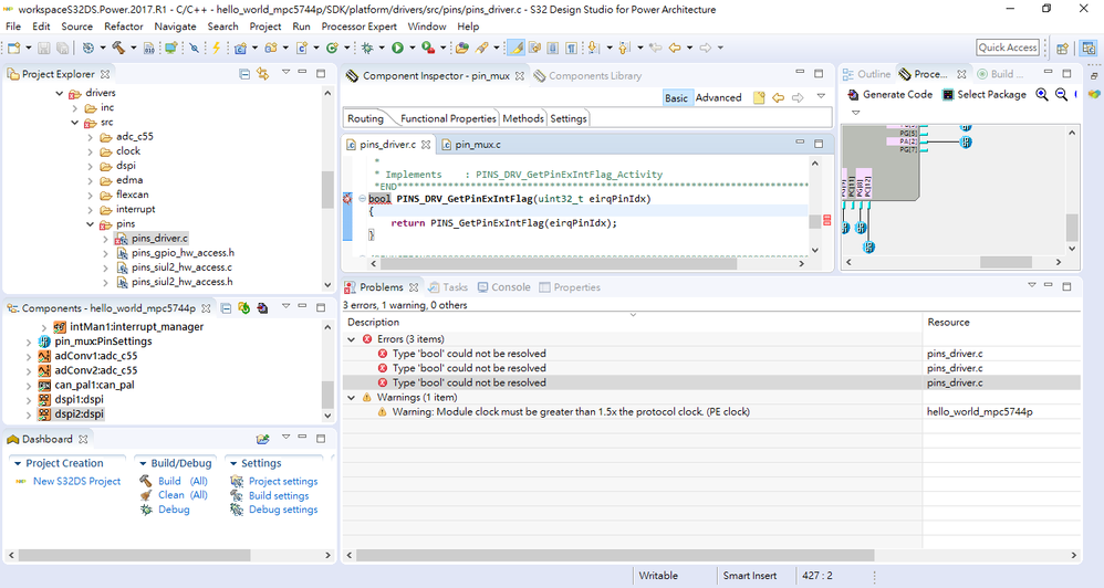

Type 'bool' could not be resolved pins_driver.c /hello_world_mpc5744p/SDK/platform/drivers/src/pins line 373 Semantic Error
why?bool' could not be resolved

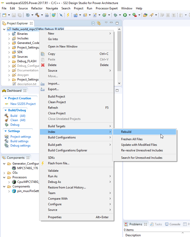

this errors ale false positive errors and it is known eclipse issue (your .elf file is build sucessfully).  For fix the issue you can try rebuild index - right click on project name -> Index -> Rebuild
Sometimes also help restarting S32DS.
Jiri

jaureshsieh
if direct build project was passed
but i click source code to modify and add code.
the show Type 'bool' could not be resolved.
you can double click add any code at pins_driver.c,that will show error.
example {
int i;
i=i+1;
will see type 'bool' could not be resolved.
how to resolved?
