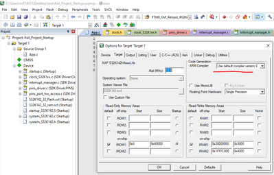

I am using keil with S32Kxx production based on "apnt 304"document.
As it mentioned in the document there is no problem using keil with S32K series :>>
but when I open an example project in the Keil this message is appeared :>>
I add some more compiler through the project menu like compiler version 6.9 but the problem was not solved.
I do not know what I can do to solve this problem!

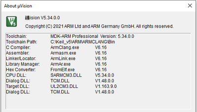

Hi@ArashK
below is my software development environment to run S32_SDK_DFP_1.5.0
It should be that your version does not support it. Please go to Keil’s official website to get the latest IDE. If you have any questions, please contact Keil’s support. T

Dear Senlent
The version of my keil is 5.38 by the way I should ask this question from keil or arm forum.
