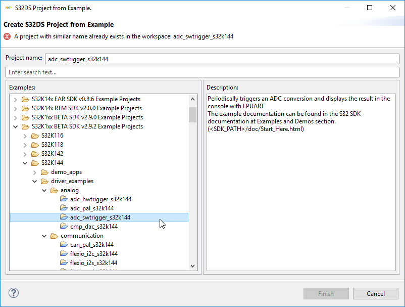

I'm facing this issue of unable to generate the Processor expert Code, as project isn't been activated in the Project Panel. Is there any means to activate the project or any means that will solve this issue?

Thanks for sharing screenshots. Processor Expert is part of SDK and your project (example) is not based on SDK.
You can use SDK ADC example insdead:

 I don't have the following example(attached screenshot) and my purpose is to generate using processor expert. Have to integrate it with other auto generate code. Can you suggest me any solution.

Did you update your S32DS installation? https://community.nxp.com/docs/DOC-341068
Even with non-updated S32DS installation you can use ADC example with Older SDK (just scroll more down in example list). The example which you are using is non-SDK example.
