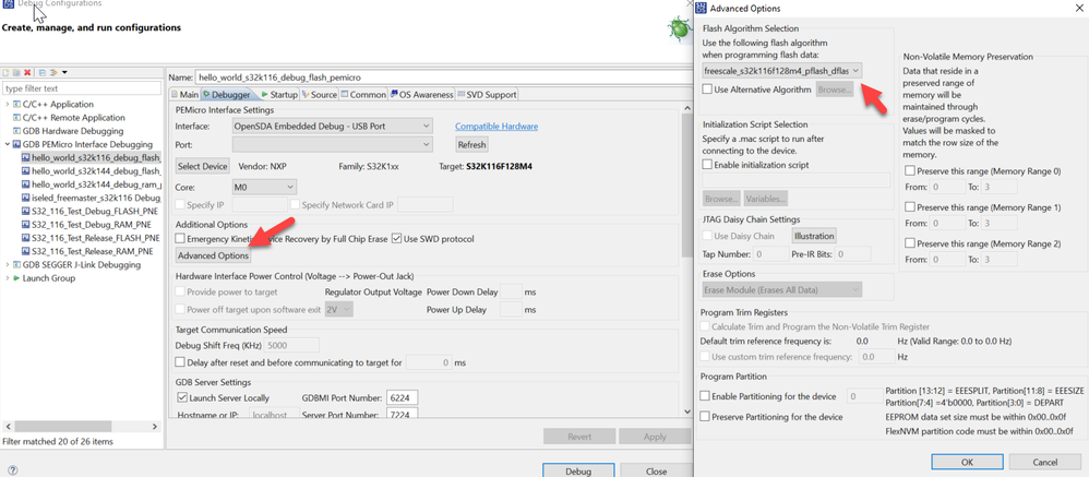

Alexis_A
Hello Bastian,
In the debug configurations there are the Advanced Options and in the programming flash data algorithm be sure that the file that it mentions is the same that you modify:
Also, if this doesn't work you could try attaching to the target and see where the code is stuck.
Let me know your findings.

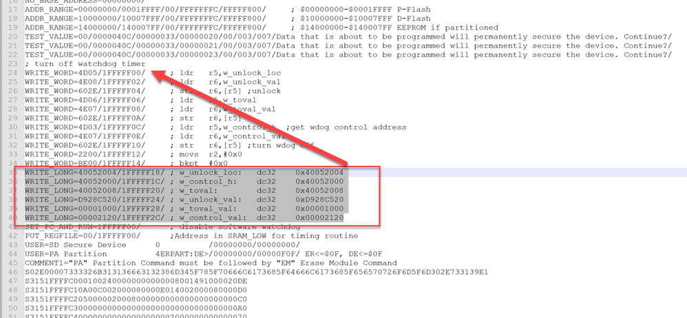

Alexis_A
Hello Bastian,
This could be due to a problem with the programming algorithm, I present the same behavior as you and check the file in the next route:
S32DS_ARM_v2.2\eclipse\plugins\com.pemicro.debug.gdbjtag.pne_4.4.6.201912192052\win32\gdi\P&E\supportFiles_ARM\NXP\S32K1xx\freescale_s32k116f128m4_pflash_dflash_eeprom.arp
It presents some differences between the others, so try moving the following lines:
Let me know if this helps you.
