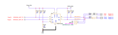

I'm using:
S32K3x4-Q172 and S32K3 RTD AUTOSAR 4.4 2.0.1 D2207.
I'm testing the serial interface (LPUART6) but it doesn't work. I can see the signal in pin 2 of J44 when I send data in TX line but on PC I can't see data arriving on serial software. The baudrate is ok and the port of board appear correctly on device manager. Also I check the power supply of NTS0102GD and everything is ok.
It must be problem with MK26FN2M0VMI18?
1,975 Views
Robin_Shen
Hi MVR,
Seems that the problem is related the OpenSDA firmware of K26. Please refer to the discussion in: request K26's OpenSDA firmware on the S32K3X4EVB-Q172
Maybe PEMicro will send you the latest K26 Embedded Multilink firmware with full virtual serial port support.
Robin
1,952 Views
MVR
Contributor V
Hello Robin,
I talked with pemicro team and updated the FW.
But it doesn't work yet, I can see the signal as I said on TX line but on serial software it doesn't appear...
Do you have any idea how can I fix it?
1,942 Views
Robin_Shen
Did you install the Virtual COM Port Drivers ?
