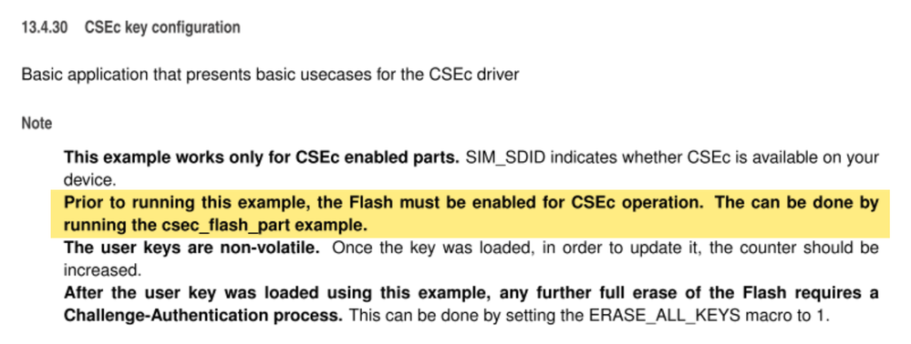

I am debugging the example csec_keyconfig_s32k116 to understand how CSEc and AES 128 encryption works.
But I am seeing that CSEC_DRV_LoadPlainKey() function always returns STATUS_ERROR.
Regardless of whether it is call by setAuthKey(), loadKey() or eraseKeys().
And I can never get to the code section where the CSEC_DRV_EncryptECB() function is used to understand it.
The only part of the example code I have modified is the define to erase the keys. Could someone guide me on what is happening?

Hi Juan,
did you follow sections 13.4.29 and 13.4.30 in this manual?
c:\NXP\S32DS_ARM_v2.2\S32DS\software\S32SDK_S32K1xx_RTM_3.0.0\doc\S32SDK_S32K116_UserManual.pdf
Did you run this example too?
Lukas

Thanks lukaszadrapa‌, Now I have the example working,
